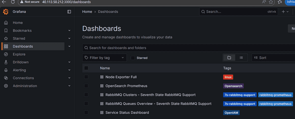

### Grafana access
The default Grafana username is `admin` and the default password is `admin`.
http://<IP of VM>:3000
<figure><img src="https://docs.openiam.com/docs-2026.3.1/static/f6b7314b0026062eee031395258fccc8/e3189/1-rpm-with-internet-02-grafana-dashboard.png" alt="Grafana dashboard"><figcaption></figcaption></figure>

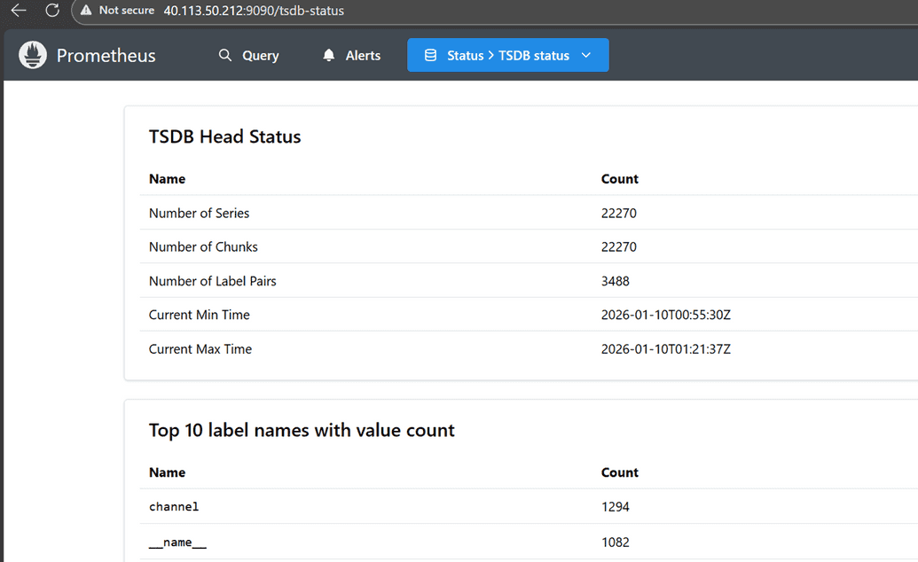

### Prometheus access
Change `web.listen-address` from **127.0.0.1** to **0.0.0.0** in this service file:
```bash
vi /etc/systemd/system/prometheus.service
Then reload and restart Prometheus:
```bash
systemctl daemon-reexec
systemctl daemon-reload
systemctl restart Prometheus
Access Prometheus at `http://<IP of VM>:9090`.
<figure><img src="https://docs.openiam.com/docs-2026.3.1/static/7bece3ea03bb0ad9fe002df3e130a114/e3189/1-rpm-with-internet-03-Prometheus.png" alt="Prometheus UI"><figcaption></figcaption></figure>

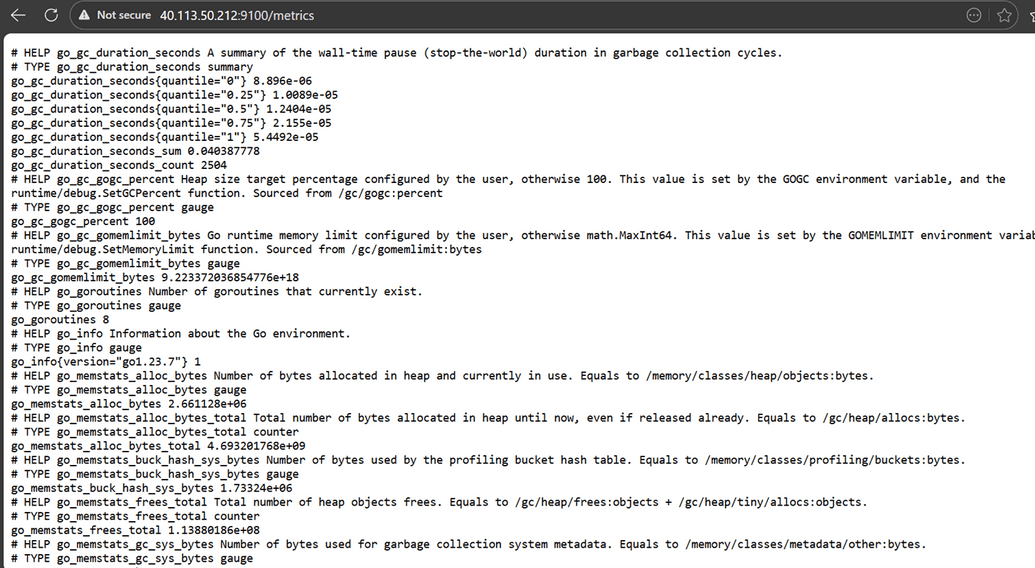

### Node exporter metrics
Access node exporter metrics at `http://<IP of VM>:9100/metrics`.
<figure><img src="https://docs.openiam.com/docs-2026.3.1/static/72a2878075ffcbfdc4606fafa20e6331/e3189/1-rpm-with-internet-04-Node-exporter.png" alt="Node exporter metrics"><figcaption></figcaption></figure>
